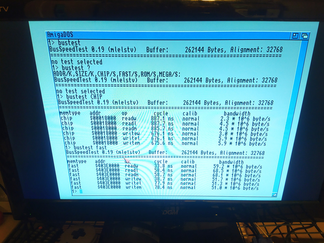

can u share bustest results?
there are for warp 1260 at 95MHz:
warp have rtg, that is i think better than having msx card..
